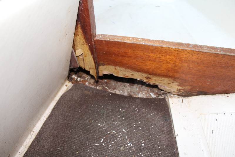

Réponse de marinou sur le sujet Réfection cloison centrale Edel IV
hello!
On my free edel 4 the lower part of the wood bulkead is also rotten.
I remove everything, so i can confirm you, behind the lower part there is foam, under the floor of the front cabin.
You're right about the damange on the seat, the lower part of your wooden mast post, that is supposed to spread the compression of your mast on the hull is totaly rotten. So the pressure of the mast is taken by the handrail, and put a heavy load on the seat, that is not design for that purpose.
You're repair project is good. You can lower the mast, put an hydraulic jack and a piece of wood to raise the roof. Remove the rotten part, dry everything, and glue a new piece of wood at the lower part of the bulkhead.
To avoid having water staying out of sight, behind the bulkhead, you can make a hole at the lowest part of the bulkhead, fill the hole with epoxy putty, and drill a smaller hole in the epoxy putty.
And of course you can protect with epoxy the piece of wood that you're gonna glue.
Hope everything is clear for you.

Hi Jazmi ! No problem ;-) I've took some picture of my pillar, water have done a lot of damage on it... :/ The first one, is on the ground, and the second one, is on the left side, in the middle of the boat. When we have buy it, we had take off almost 50 litres of water from inside...
attachment=1320]IMG_1629-min.JPG[/attachment]
