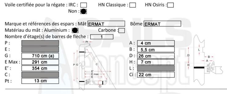

Hy Cuy1
No problem for English text.
I took measurement on my E4 2 years ago. This is my measurements
Measurement in g permit me to sail with the roof open. I you don't want to sail with the roof open you can add 15cm :)
I hope it will help you
Regards
